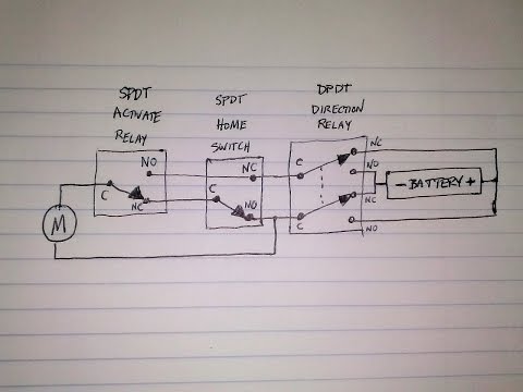

I knocked this circuit up as part of a bigger project and am sharing it here in hopes it helps someone someday. It was a fun little side project. All mechanical, but ultimately will be controlled by a micro. One-directional homing circuits are simple and nothing new, but this one "goes both ways." That's as PC as I get. The thumbnail is my hand-scrawled schematic.
    Attaching schematic since it gets partially obscured in the Youtube window.

    Wow, this brings back (mostly good) memories of exploiting the "park" position of a windshield wiper motor.
    justanswer.com/uploads/sasso1179/2008-09-01_204230_wiper.gif
    edited 2016-08-26 17:35
    Yep, similar to wiper homing. But this circuit differs in that it drives the motor both ways (many wipers oscillate mechanically and the motor rotates in one direction) and this one does dynamic braking to stop the motor quickly and avoid overshoot.
    BTW, your GIF won't load, hatallica.
  • Weird ... the GIF shows on my computer.
    Dare I ask what the larger project is, that will be utilizing the bi-directional homing scheme? Low idle power, 360-degree/step stepper motor drive?
