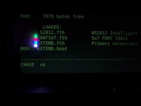

  • I know my interface in Tachyon doesn't really care about how each byte is used as it will just transmit the array and if that array is arranged as RGB or RGBW it doesn't matter. The only difference is at the high level when the array is written is written, that's all, and that is a very easy thing to tweak.
    Whereas before where I defined WHITE as RGB now I specify it as the 4th byte so I can type WHITE 4 LED and the 4th LED will instantly be white vs say MAGENTA 4 LED.
    So hooking up these RGBW LEDs even to any standard WS2812 driver should make them light up except the colors beyond the first LED will be messed up.

    edited 2016-03-28 03:39
    Check this youtube link where I play with the WS2812 and Tachyon. (Actually there is a better demo video but I just have to find it!)
