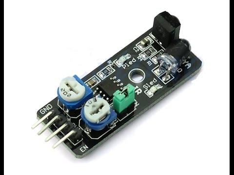

    These $1.65 four-pin IR modules emit a 38 khz IR signal to look for a reflection as obstacle sensors. There is an ENable pin which can turn off the IR signal, then the unfettered 38 khz receiver module can detect signals from IR beacons or remote controls. Uses a rare low-gain continuous signal compatible IR receiver. Double duty, slick and cheap. BUT, quality varies wildly. Order twice as many as you need, some will be better than others, you need to test, adjust, and sort into matching groups. Quality-wise, I see modules with wildly different (and often transposed) pot number values. Note the difference between the Ebay link unit and the image in my Youtube still (also lifted from Ebay). Probably misassembled, the values rarely match the numbers screened on the PCB.
    Edit: I used and wrote about this sensor at http://servo.texterity.com/servo/201512/?folio=44&pg=44#pg44
    Do not bother with 3-pin modules, which only use DC IR light levels.
    http://www.ebay.com/itm/311523477616
    Extended range when a big Scotchlite reflector is used. Coupled with an ultrasonic sensor to verify range, you could so some impressive feats .
