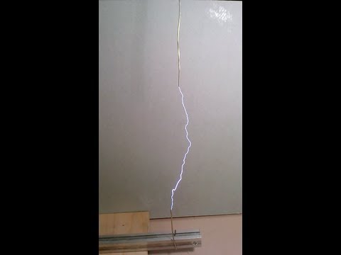

    Take that voltage up a notch by a factor of 1000 and you have a Marx Generator ... :-)
    This one produces about 450kV with each stage being about 35kV. The idea is that each stage is charged in Parallel via a high Ohm resistor (5 Megs in this case)... When the voltage reaches enough to jump the spark gap, then an over voltage is produced instantaneously on ALL of the remaining spark gaps. You can control the initial spark gap by having one spark gap slightly closer than any of the others. When a spark is initiated, the spark itself acts like a dead short (a few Ohms) and effectively places ALL of the capacitors in series ...
    There is Video also:
