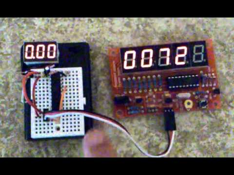

    Built my kit in ~45 minutes and 2 beers. Fired up perfectly on the first test. Playing around with a BS2 right now. Will advise after I split the atom.
    A fun build. Nice quality PCB solders easily. Ah, the combined aromas of rosin core solder and brewski. So very nice.

  • OK I finally built my kit. Works nice, had fun going through a big drawer of old crystals.
    On the plus side this is a much easier build than the oscilloscope. The board is much more open and better labeled, there are a lot fewer parts, and there are no grounding planes to make soldering difficult. You do need to watch the capacitor values, one of the 22 pf was stamped crookedly and I mistook it for the 102 at first.
    On the minus side the documentation sucks compared to the oscilloscope; they do not suggest component order, which the oscilloscope does to keep you moving from short components to taller ones so that parts don't fall out while you're soldering them, and they offer no ID hints or other guidelines, just a picture of the finished board. You can pretty much guess the resistors by quantity but they all look very similar. I used the magic component identifier as I did on the scope kit.
    I had exactly the same, one crooked 22 stamp. :)
    Agreed, all those light blue background Chinese resistors are impossible to read. Multimeter resistance checking is essential.
