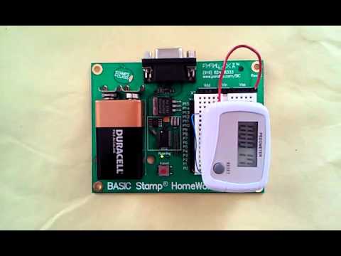

Retasking an Ebay Pedometer (step counter) to count pulses from a BS2. Internal debounce circuitry limits count rate to 4 Hz, but if you need a slow cheap counter w/LCD display and power-off memory using just one I/O pin, it's gonna be hard to beat 80 cents: http://www.ebay.com/itm/151424158305
A simple mod to remove the internal pendulum and make 2 connections:
1) to battery - (wedged wire under button cell) and
2) to the switch contact through a 100K resistor
A 1 ms high pulse is sufficient to count:
You could add another wire to let the micro reset the counter if you like.
FOR B0=1 TO 39 PULSOUT 0,1 PAUSE 220 ' counter starts missing under 220, call it 4 Hz max NEXT
