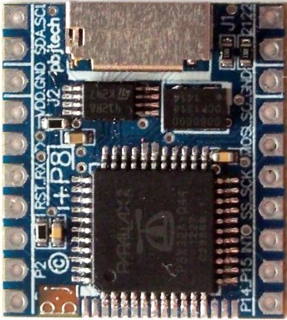

    I use those little 3.2x5mm 6MHz oscillators on my P8 module. Probably a little larger than those tiny ones you are using but still very small and easy to handle. They cost just over a $1 in quantity. I can get smaller ones again, 1.6x1.2mm but they cost a little bit more.
