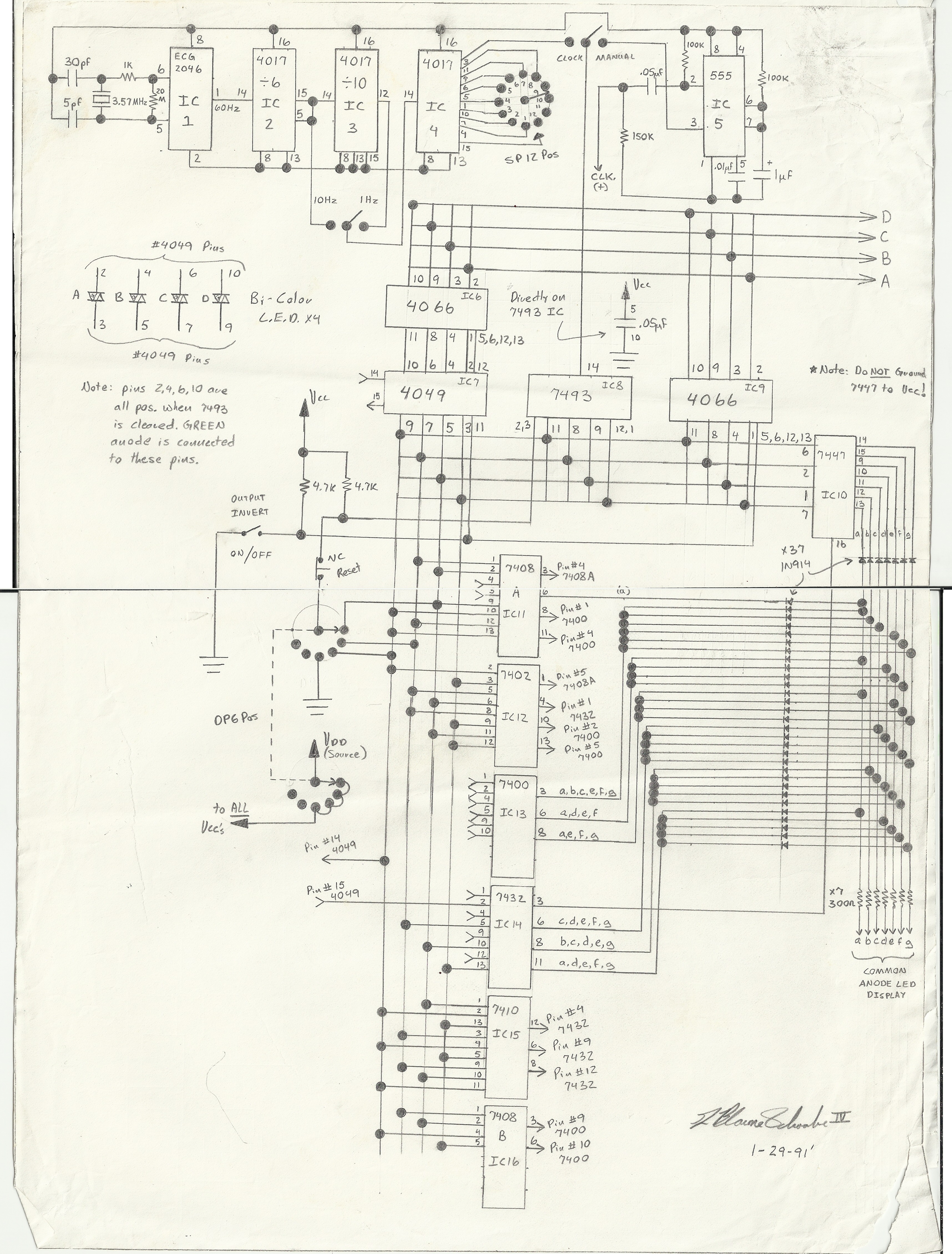

    Found It !! My Diode ROM application ( 1991 ) ... Yes, I never throw away anything :-)
    Back then we simulated our logic on paper !! ... and we liked it !!
    For an assignment in an early electronics class we had to demonstrate our knowledge of designing with logic gates. Here is a design that I was able to fit into something the size of a pack of cigarettes including the battery. The design had a 60Hz time base that I divided down to 10ths of a second or 1 second clocks, or you could manually clock the counter. A 7447 BCD to 7-segment was used, but to get the LED's on the seven segment to display HEX, it was necessary to decode the remaining BCD with discrete logic gates since the 7447 would only go from 0 to 9 .... In order to do this DIODE ROM was used to get "A" "b" "C" "d" "E" and "F". I got an "A" on the assignment. :-)
    http://bscircuitdesigns.com/Electronics.JPG

    It sure took allot of chips for that design. How things change :)
