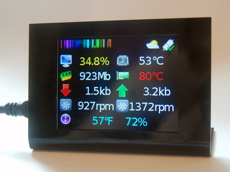

Or anything like it?
I'd like to have something a little closer to the terminal windows application, rather than the 4 line LCD that Parallax sells. Having a handheld terminal piece of hardware with the ability to send a DTR command and CLS command would be ideal actually.
http://www.ebay.com/itm/USB-2-8-TFT-LCD-module-LCD-sys-info-display-temperature-fan-AIDA64-LCD-Smartie-/121004607232
    edited 2015-01-13 15:07
    Hi Brad,
    the one you linked to has a usb-interface 320x240 pixels and colors
    Serial RS232 would be much easier for the prop.

    I agree with Stefan, that particular display doesn't look like it's a good match for the Propeller.
