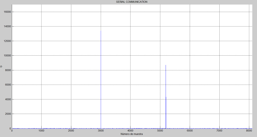

  • sebastian1989sebastian1989 Posts: 14
    edited 2014-12-30 14:03
    Hello, I am using your code in a project where I need to get a FHT from a signal, I add a spi RAM (23lc1024 1Mbit) and a ADC (MAX1168 16bit 200Ksamp/s) all this in the same cog, with the new library I read N samples from the ADC and write directly in the RAM, then I make the FHT in the RAM.
    Now the problem, I need the FHT from 16384 data points but doesn't work well, can anyone help me? I dont understand completly how your code work, I am new in PASM (and english XD).
    If I reduce the data points to 8192 all works nice.
    The image show the problem, It's like aliasing but it is not.
    The clock output in my code is for a low pass filter, I use a MAX293 (8th order low pass filter with a variable cutoff frecuency, "electronics witchcraft")
    "serial fht.spin" is an example.
    "matserial.m" is a script to receive data from serial and plot in matlab.
