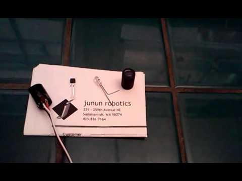

I still love my Hamamatsu S6986 laser sensors, but I've been playing with a safer, laser-free alternative. The Sharp IS471F uses a simple IR LED as a short range proximity sensor (3-4 inches). I found that by adding a small lens to collimate the IR beam, I could detect Scotchlite reflective tape from 3-4 feet away. I have more experimenting to do using bigger lenses (ordered) to possibly increase the range. The sensors are simple to use, cheap ($3) and in abundant supply from Junun. Video is self-explanatory. I'll have a Boebot navigating between reflectors soon.

    Where did you get the lens? is it adjustable? is it just a hollow tube with a lens on top? will it chop lettuce and dice tomatoes? Do tell.

    I had several small convex lenses laying about, so I used those. No adjustment, the focal length dictates the tube length. I built & tested with a 5mm red LED to optimize focus and then swapped in the IR LED.
    A bigger diameter lens might increase range, so I have ordered a few to try. Once I arrive at a favorite lens & geometry combination, I'll share.
