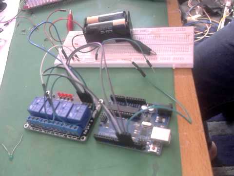

    Hello, I got around to the Yrobot 4ch relay board you can get for under $10 on ebay, well $2.99 to be exact . The easiest way was to just record as the web camera is always pointing to my desk. no setup required. Sorry for the microphone setting, it has a lot of background static from not checking the audio settings.
    As Im typing I have just started to think that if I connect the microcontroller and set the four pins IN1,IN2,IN3,IN4 to high then it might turn off all the relays ? I'll try that in the meantime.
    I couldnt find the Quickstart when i started the experiment but it has shown up during the video :)
    EDIT: I can't get the relays to work at all. I set all the pins high then connected the ground and they werre all off so I though that was the answer but when i then sert the pins to LOW nothing happened. So then I just went back to unplugging the arduino and unlike before when all the relays were on and the red lights lit up I get nothing. Its like the board is dead ?
    EDIT #2; Well its working. When pin on relay boartd is set to LOW it operates the relay and the red light goes on. Turn it off by setting the pin to HIGH.
    but is there something a little bit wrong with my wiring that when i disconnect the microcontroller then all relays and their lights are on ?
  • whiteoxewhiteoxe Posts: 794
    edited 2014-08-10 21:38
    It just seems a little bit wrong. Setting pins High the Relays are off, but the red LEDS can be seen to just slightly glow if you look hard. Setting pins to LOW then they are All turned on with a loud click and red LEDS glow brightly.
    I think its all working correctly. Just being Active Low, threw me for awhile.

    Just trying to understand the difference between these two relay boards. Appreciate any comments. The relay board I am using is just switches that provide no power themselves. just simple switches. Im currently just turning a motor on and off with HIGH/LOW.
    Whereas this very similar relay board has switches that also supply power from a supply connected between 5 and 24volts. Which seems to me to be slightly easier type of relay to use.

    What are the part codes on the transistors ?
    You should always test suck unknown Boards first with a variable control voltage (eg a second power supply) to check the switching thresholds. ON and OF will be slightly different.
    If they are PNP transistors connected to 5V, that would fit your observations.
    The Prop cannot drive 5V, so the LEDs are on faintly, and then a LOW turns them on more.
    The problem here, is temperature and supply skew can move that just slightly glow effect, until a relay that turns on, can fail to release. Not a good design/use.
    Worst case test is probably 3 relays ON and an inner relay going from ON to OFF.

    thx jmg, I powered the relay board with a 5.1 volt power pack, I used an arduino because I temporarily lost the prop board. Im just using the arduino to set pins HIGH/LOW. iVE SORTED IT OUT. caps again sorry..... ;)
    What I am curious about in the yellow overlay is where it has the 5 to 24 volt input, is that just giving me the operating range of that board or is that also used by the switches to source power, or do I still need another power supply and the relays are only switches. I've really not used a relay before no matter how simple or old they may be ? Well a single relay on a breadboard ages ago.

    Reverse reading the image, which shows the tracks and plane connections, that yellow board powers at the relay voltage. So you can use 5/9/12/24V relays.
    The Logic threshold is set by 2 resistors and the SOT23 device, likely a NPN - so the point where the relay turns on will change slightly with 5/9/12/24V, but not much. Expect a TTL level of 1.5V~2V, with > 2V => Relay Coil ON.
    If you can read those resistor values, you can calculate the nominal switch point, but as I've mentioned before, better to actually measure what happens, then you learn more.(and eliminate false assumptions) & confirm the board does work before you apply software.
