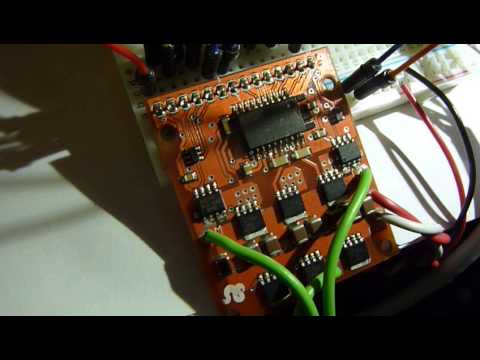

    Very soon: The board setup:
    And the motor running a random positioning loop
    The motor is a C.S.SET 800W 3A 3-phase washing machine motor (used in
    several models of washing machine, £20 on eBay).
    There are 4 cogs, one does current sensing feedback to drive the bridge
    and keep the stator currents at their programmed value.
    One calculates the stator currents from the current rotor position and
    slip speed and flux/torque drive levels - sine table lookup and multiplies
    One reads the encoder AS5040 (SPI interface) and maintains a PI loop
    angular frequency and phase using a counter module in NCO mode, also
    generates the slip phase from slip velocity the same way, writes current
    values to hub regularly.
    One cog is top level simple positions PID loop in Spin - sets the flux, torque
    drive levels and slip frequency, detects position error.
  • Mark_TMark_T Posts: 1,981
    edited 2014-06-28 08:20
    And some info on the 3-phase MOSFET board. I found LFPAK devices with 100V and 13milliohm, PSMN016-100YS
    LFPAK is basically SOIC8 with 4pins combined into a drain tab, so good heat dissipation and easy to solder for an SMT.
    FAN7388 (my favorite 3-phase bridge driver, never blown one yet) provides the gate drive, and a couple of ASC711's
    sensing the current (+/-12.5A, 0.11V/A sensitivity) each feeding a ADCS7477 SPI ADC (1MSPS, 20MHz SPI).
    Schematic:
    layout:
    End connector strip supplies GND, 3.3V (although the ASC711's and ADSC7477's will also work at 5V),
    12V for the FAN7388.

  • ManAtWorkManAtWork Posts: 2,207
    edited 2014-07-01 04:03
    Very impressive, Mark! I'm currently also working on a propeller based VFD/servo controller: http://forums.parallax.com/showthread.php/155731-measuring-voltage-with-RC-slope?p=1269144&viewfull=1#post1269144
    What is your control strategy? I think the vector control used in VFDs for induction motors don't work at zero speed you need for servo control. Do you drive the motor like a stepper with constant flux an adjust the field rotation frequency to compensate the slip? Or do you use a more advanced model trying to guess the rotor winding current?
    I only support synchronous (permanent magnet) motors for servo control or simple V/f speed control (non-vector) for induction motors.
    edited 2014-07-01 07:05
    Just found this. Where did you get your mosfet board? Would that 800 watt motor power a go cart? Any guestimate how many automobile starter batteries would be needed?
    Because I NEED another project that requires a helmet!
    edited 2014-07-01 08:28
    I designed it, fabbed by ragworm.eu, soldered using my converter toaster oven!
    I've not ventured any higher than 30V yet, the current board would go to about 80 or 90V, but the motor's
    designed for 195V so getting to 800W would need either high voltage supply and a reworked bridge (probably
    something like this IGBT module would then be appropriate:
    http://uk.farnell.com/fairchild-semiconductor/fsbb20ch60f/ipm-igbt-20a-600v-spmca-027/dp/2322642
    A better bet for traction is re-wiring a motor for lower voltage, say 48V 20A and using bigger MOSFETs.
