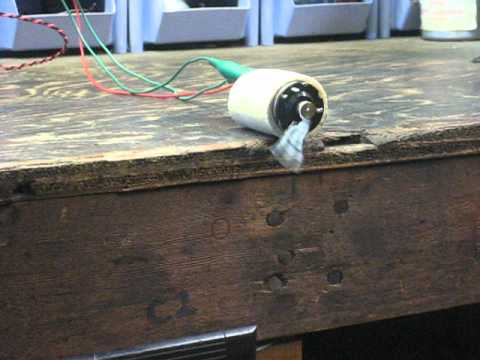

  • TappermanTapperman Posts: 321
    edited 2012-09-03 16:24
    @Phil,
    Thanks ... that did the trick!
    [video=youtube_share;F5uWjCAjpfQ]
    ... Tim
