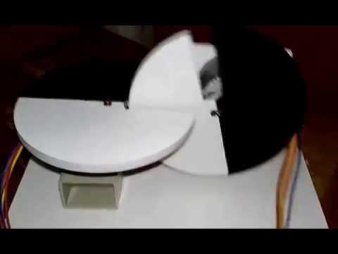

Man, it's a lot of work coming up with something that makes those $2 Chinese stepper motors look useful. They're sloppy, lots of backlash, slow, low torque, just not a lot of good things to say. Here's a quickie demo that without any load, they can repeat 360-degree turns for a while until they get hot. Why hot? They are 5V motors driven at ~12V here just to make them faster and repeatable. I was considering making a drawing bot with these, but I will have to find other motors more suitable after seeing how frustrating this simple thing was to do.

    Those motors look pretty nice, really, for only two bucks. How are you driving them? If you're driving them directly with 12V, it's no wonder that they're getting hot. You could obtain the same performance with less heat using a current-limited PWM drive or a simple series-resistor drive that provides the initial oomph but limits steady-state current to the motor's specs. In fact, you could go up to 24V with such arrangements for even better performance that what you're getting now.

    Excellent calls, PhiPi. Yes, I'm using a straight connection to 12V worth of Li-Ion batteries. My hope was to achieve higher RPM and limit current by switching the coils on for a few microseconds, but these motors only go so fast before they start skipping pulses. I do like your series resistor drive idea, but IMO it would be wasted on these cheesy motors. When I find some decent, low backlash steppers, I'll be chatting with you again, my learned proponent!

    Ack, there was something about those turning discs and your camera work that made me dizzy.
    I wouldn't think over-volting steppers would make them faster. It does increase torque, though, so you can run them at higher PPS rates without their skipping steps.

    Using a higher voltage has the advantage of getting current to flow in the motor coils more quickly. This translates into a higher possible step rate. With a series resistor, the coil will "see" the higher voltage until current starts to flow, then settle to the rated voltage when the current reaches its rated value. This so-called RL drive is very inefficient, though, since the resistors dissipate so much energy as heat. PWMing a high voltage with current feedback is much better, but more complicated.

    It might also be Youtube's autostabilization effect. I checked the "Shall we fix the shakiness for you" box on this one.
