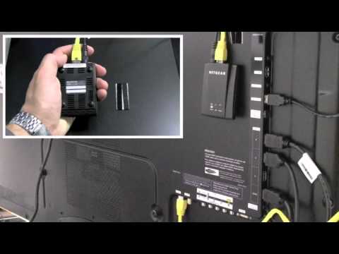

    Use a simple WIFI adaptor?
    This shows connecting an HDTV, but it should work with other devices.
