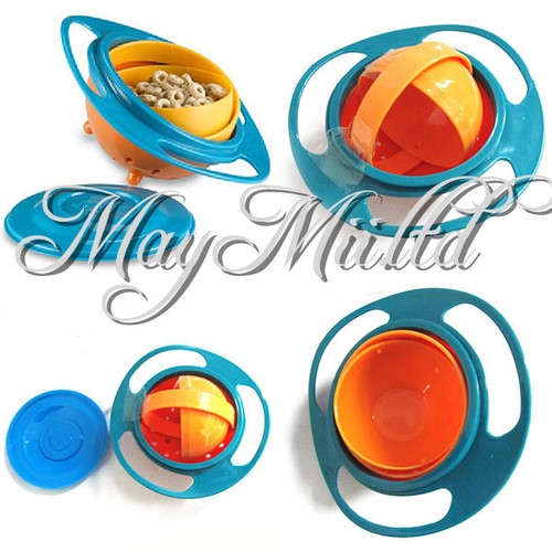

Um, there's always gravity! Hang it by a string or use this.
$80 What?
Haven't you ever heard of ebay? $4.99 shipped (and I've sure there are better deals)
It's also weather proof and would look great on your yacht.
