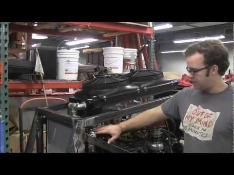

  • Mark_TMark_T Posts: 1,981
    edited 2014-03-02 03:51
    Ah, I understand now. You need a specialist control system, hydraulic actuators are non-linear and
    a simple PID loop is unlikely to be sufficient, the Project Hexapod folks had a lot of problems with
    closed loop control of a hydraulic robot leg, don't expect this to be easy.
    See from 1:43 in this video - their simulations accounting for the effective backlash of a
    hydraulic system show huge oscillations...

  • Kirk FraserKirk Fraser Posts: 364
    edited 2014-03-02 07:11
    Beau, On first look Myography looked weird and complicated but with your second post on it explaining how you used it, it got me thinking of paying attention to how my muscles change over when letting a weight down. I'll think on that more, it seems like a solution is there to be discovered. Thanks.
    Mark, Interesting video. I especially liked the dual pump and the cute accumulators. My accumulators are just long pipes. I hadn't thought about running a simulation. Thanks.
