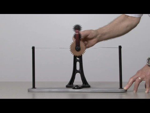

It's not real mysterious at a second glance. The orange arm and the main black arm are the same length and counter-rotating, so all of the vertical motion cancels out. _+ Sin, -Sin and all that. Looks pretty cool though, probably easy to build with Lego parts.
Being a software guy I decided to understand this by modeling it in software. So I took my Processing Scara arm IK code and reproduced the behavior. I was able to do so if for each degree the humerus moved counterclockwise, the ulna moved two degrees clockwise. The full code is at the bottom, but the critical two lines are:
robotArm.setShoulder(robotArm.getShoulder() + ScaraArm.ONE_DEGREE);
robotArm.setElbow(robotArm.getElbow() - 2 * ScaraArm.ONE_DEGREE);
