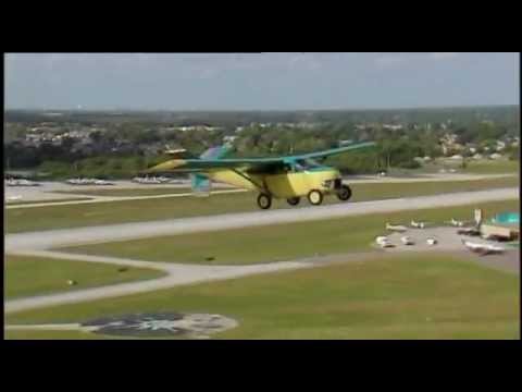

Called Aeromobil, the car was created by Slovakian engineer Stefan Klein, who's background includes work for Audi and BMW. Based on the outlines of a single-engine plane, the Aeromobil version 2.5 draws power from a 100-hp Rotax airplane engine, and can travel 430 miles on a load of fuel in the air or 310 miles on the ground. When not in use, the carbon-fiber wings fold solidly behind the two-person cockpit, disengaging the rear propeller.

Having said that, all those transformers are sofabeds, though. Not a good sofa, not a good bed. Anything light enough to fly probably wouldn't fare too well in an automobile crash test against something weighing 2-6 times more. IIRC, most of the previous Aerocars (and Bucky Fuller's airplane-like Dymaxion) are always in the headlines, yet always one crash away from oblivion. This one looks a bit wobbly in the air, and is there a reason it never gets more than 20 feet altitude? How long is that runway anyway?

And that can probably explain some of the wobble, too... the craft is experiencing excess lift because of ground-effect, and I have my suspicion that it hits the aft end harder than planned.
Either that, or the ludicrous angle of the 'car' part is causing heavy turbulence for the control surfaces.

Just basic aerodynamics: Regardless of what airfoil you are using, drag is the price you pay for lift. You can't get one without the other. A car stationed on the ground has 'lift' without expending any energy to achieve it.
Edit: You've probably heard that the three keys to real estate are location, location, and location. There is a similar rule in aircraft design. Design it light, don't make it heavy, and be sure it doesn't weigh too much. I can't imagine the designer of this craft would have incurred the weight penalty of separate engines for road and air.
