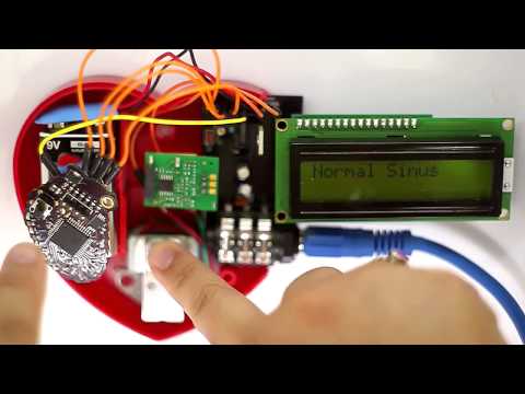

Hi everyone! After nearly 1.5-2 years of learning how to program, using the Propeller, learning how to design/create boards, and getting a little push from the Micromedic competition - I present, Tymkrs HeartMe, the LED Cardiac Simulator!

    Thanks Frank! Um, so the heart portion is available: https://www.tindie.com/products/tymkrs/tymkrs-heart-me-v2/
    In terms of the rest of it, I'd love to make it a kit, but I haven't be able to find a good source of solenoid + valve plate combination that's easily/cheaply acquired. And I'd also love to try doing some form of ecg from this- I am sure the Propeller could handle it. I just don't know how to start doing it haha. I've been meaning to look at previously done ecg projects by folks here, but it may have to wait until after the Micromedic contest ends :). Glad you like it!!

    So besides it being a project for Micromedic as Publison has said - it was a project that allowed me to combine my cardiovascular surgery career with my electronics hobby. It's an led heart simulator, and has already been used to help student nurses learn about rhythms and patient assessment!
