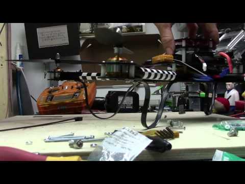

    I've noticed that the landing gear is a weak point in the design. I've easily broken two pieces so I came up with this solution.
    They're made from large nylon wire ties from the electrical section of the hardware store. I replaced the out board screw with a #6 x 32 screw and nut. Simply cut to length, drill a 1/8" hole in each end and install! They work great and absorb the shock of a hard landing.

    The landing gear were in fact a weak point, and we have since made changes and are now making them out of HDPE, vice Delrin. When you have a hard landing with the new landing gear, they will bend instead of break like the old ones did. Once you pick your quad up after that hard crash, with the landing gears bent, you simply bend them back, and you're off and flying again.
