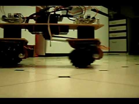

Here is a second look at dual steering, this time with full 360 steering. and Roomba motors for more power.
It is still in the devolopement stage, and has much room for improvements, like suspension, and flashing lights...
This close up drawing shows the top secret power distribution system that enables the super spin action..
Might be a little hard to make it out in that mess of wireframe, but you can get the general idea,
Springs are from ink pens and soldered to the smaller square brass tube, and that slides up and down in the larger tube.
Now that I built the thing, I want to redisign the whole assembly and make it horizontal instead of vertical like it is now,
I think I can make room for twice as many rotating connections, and that should make for a good light show...
And here is a very short video of one "axle" set spinning with great abandon...

    Great work Tommy! Caster the Wobbly led to Caster's End, which led to Roomba's Revenge. Nice evolution!
    What's your battery voltage, and how much current flows through those spring slip rings? I always thought those Roomba motors must be current hungry with their rubber drive belts, they don't feel very efficient when I spin 'em by hand.

    Anyway, You asked about voltage and amps, Well, the two batteries are 7.2v 2000 mah each,
    Wired in series, for a whopping 14.4 volts.
    As for the amps the motors use, I will have to measure with a meter and find out for sure,
    But would it help to say, when I stall the wheels, the transistors(TIP120 and TIP125) just slightly warm to the touch..
    Not very scientific I know, but hey, I'm a carpenter, whaddya spect?. :)
