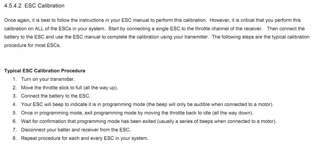

You want to make sure and calibrate the speed controllers one at a time while connected directly to the receiver (throttle channel) before you plug the speed controllers (and receiver) into the HoverFly board.
I understand how to change gear channel's default settings:
I don't understand how to calibrate the speed controllers.
Could you give a little more detail on this?

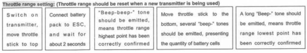

I don't know how much RC experience you have, but I've built and flown many different airplanes and helicopters and I still thought setting up the ELEV-8 was a challenge.
I've made some screen shots of the pertainent sections of the ESC instructions and the HoverFly instructions.
Here are the instructions for setting the ESC range for Turnigy speed controllers (I think these instructions also work on "Hobby King" brand ESCs).
Each ESC needs to have its range set individually. Here are the HoverFly instructions for doing the same thing.

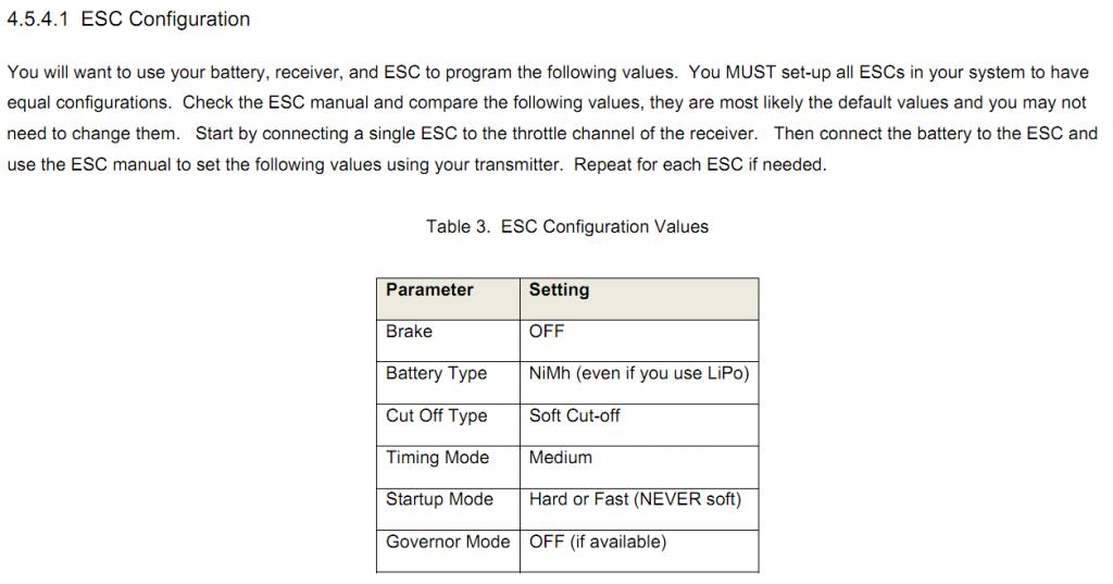

You also need to configure each ESC. Here are HoverFly's instructions on what configuration settings to use.
I think the reason "NiMH" is used for the battery type is many ESCs will reduce the power level when the batteries drop below a predetermined voltage. It's fine with an electric airplane if the ESC starts to reduce the power level to the motor, but with a quadcopter having one ESC starting to reduce power before the other ESCs is likely to cause severe control problems.

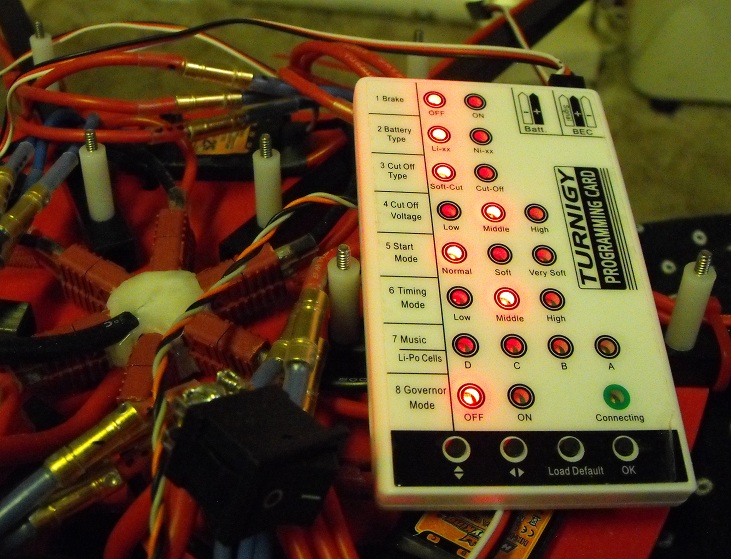

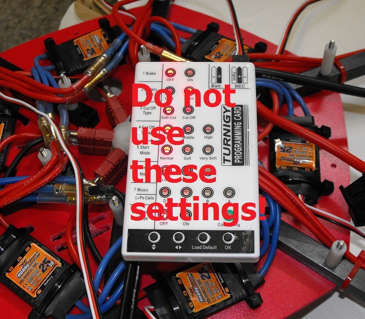

I was just configuring my six ESCs today and I stop to take a picture of the programming card.
I hope someone corrects me, if I'm configuring these incorrectly.
Each ESC needs to be configured. Make sure and press "OK" before disconnecting the programming card from the ESC so the new settings are saved.
Edit: The "Timing Mode" should be set to "Middle" not "Low". I also ended up using Nick's suggested battery mode settings. See post below for updated picture.

I just realized I thad the "Timing Mode" set incorrectly in my earlier post.
Here's what I hope are the correct settings.
Once again, I hope Nick and others will correct me if I'm wrong.

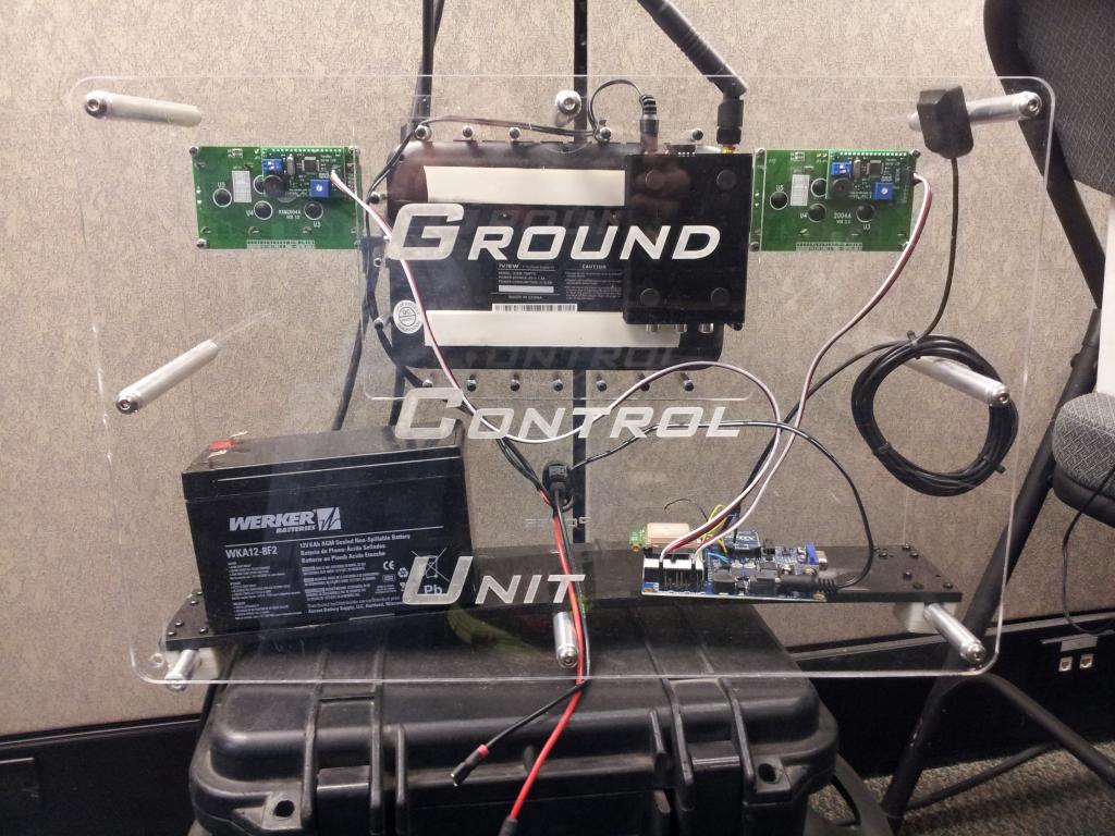

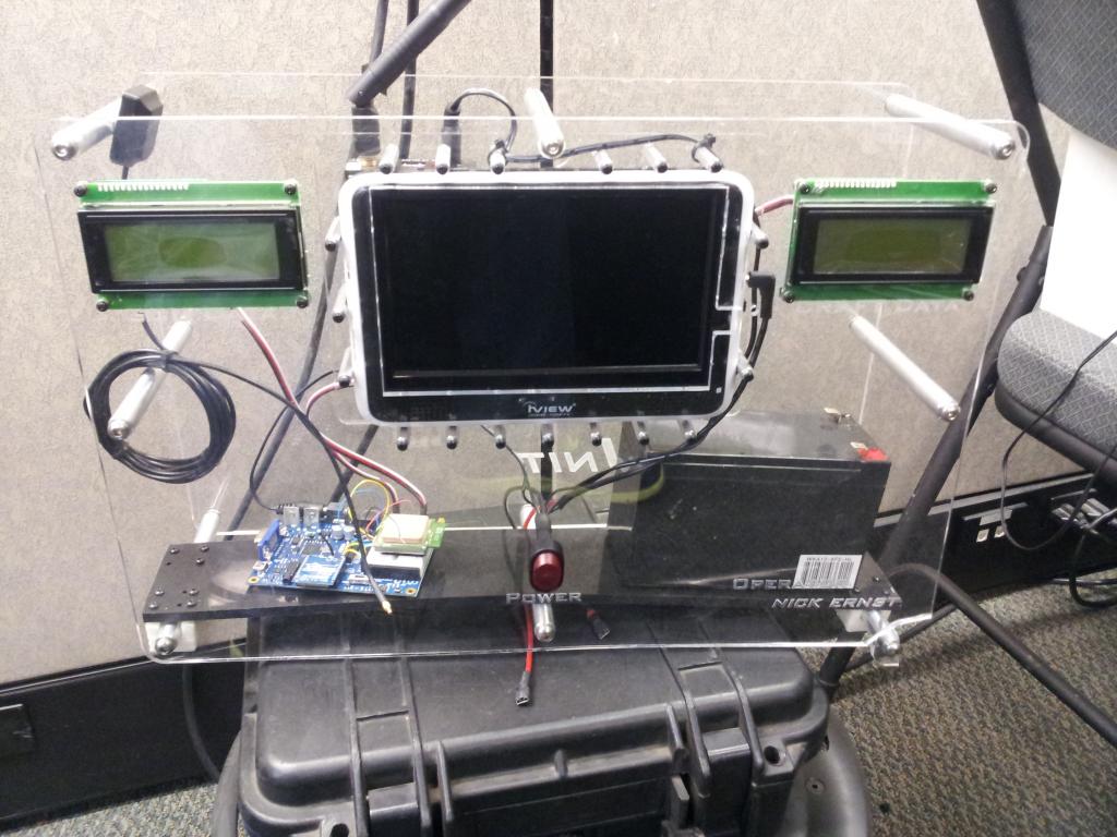

Everything looks good! With your current setup you will really be optimizing the potential of your batteries and your gear, and should get optimal results! I am also very interested to see what you do with your ground station, as I have done a less feature rich version of what your plans are, but I wanted to have a few pieces of information when I fly. I have the two LCD's which give me the Lat/Long of where I am at, and also one for the Lat/Long/Alt/Airspeed of the craft, along with housing my screen for when I fly FPV. I attached a few pictures, and I will post pictures of my GPS antenna tracker when it has been re-fined one last time!

So far my "ground station" is a LCD TV with the video receiver and battery (one of my 3S 5Ah packs) tied together with Velcro. I haven't had the guts to fly the quad using FPV yet.
I think you posted some information about the gear you're using in the ELEV-8 camera thread, but I don't recall how you're getting the GPS inforation from your quad back to the base station?
BTW, very nice looking base station. You've given me several ideas I might include in my own.
I look forward to seeing your antenna tracker. I'm debating buiding my own or ordering a kit to save some time.
