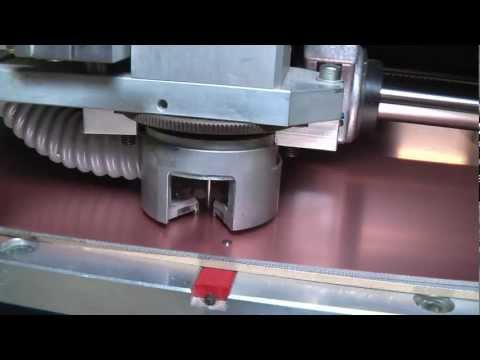

Here is a video I threw together showing my LPKF PCB milling machine.
I bought this machine from BEAN about 2 years ago. It has taken some time to get the hang of the machine, but well worth the effort. This video shows my first attempt at doing a double sided board. Even though I failed due to a simple mistake I made in configuring my layers, it should be pretty easy.
In the near future, I'm going to add a prop to monitor the starting and stopping of the motor and turn on the vacuum automatically. The PC sends text commands to the machine and it looks pretty easy to intercept the Motor On/Off commands. :-)

Thanks for the info. I may still use the Prop route so I can display other information local at the machine like motor RPM. I have taken a peek at the control protocol and it seems pretty straight forward.
