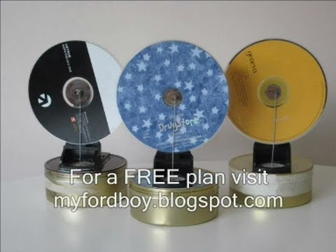

    While that engine is an example of fine metal working. There are many easy to build Stirling Engine plans on the web which can be built. Here's one that uses a sweet tin, a CD flywheel, some hobby plywood, and latex diaphragm.
    A diaphragm piston is fairly low friction and I've seen this concept scaled up to much bigger engines using thicker rubber sheets. People have also cast pistons out of JB Weld inside a copper pipe which works even better.
