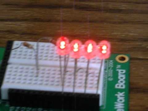

Someone on another forum was asking about PWMing some LEDs, so I just had to bust out out my HW board and have a go at bit-banging pwm. Simple code is the best! I remember PJ was playing with this a while ago, now I see what all the fun was about. LED illumination isn't perfectly linear, so I had to play with the series resistor to get it to "look right". It looks better in person than on the video.
' {$STAMP BS2}
' {$PBASIC 2.5}
PAUSE 1000
B3=20
a:LOW 0:HIGH 2:LOW 4:HIGH 6
PAUSE 200
FOR B0=0 TO B3
B1=B3-B0
HIGH 0:LOW 2 :HIGH 4:LOW 6
PAUSE B0
PAUSE B1
NEXT
PAUSE 200
FOR B0=B3 TO 0
B1=B3-B0
PAUSE B0
PAUSE B1
NEXT
GOTO a
