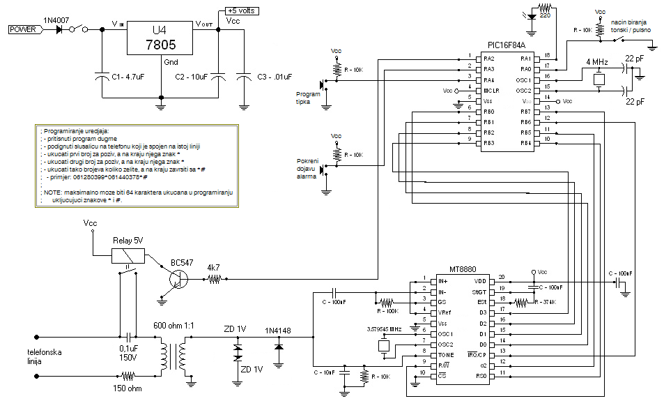

I'm new on his forum, so i hope i post my questions in the right place..I couldn't find answers in other posts. I know this is not really a problem with a parallay chip, bu since i use them in the project too maybe some of you would already have the same propblem...
I'm on a project that uses a emitter/receiver DTMF (MT 8880) wired to a bs2p40. Others MT8880 wired to bs2p (each) are waiting for the first MT8880 to emit "his" code and then need to answer it by emitting an answering-code. The problem is there are only 2 wires. One for the ground and one for the power and signal (still don't know how we're gonna manage that^^). So my questioin is about the MT 8880: As the transceiver needs to be emitter and receiver without having wires moved, can i just wire the tone out pin from the MT 8880 to the IN- pin from the mt8880 without having problem ?Or do i need to place some other devices to be able to do this?

The tone input and tone output can be connected together as shown in the attached diagram I found online.

Thanks stamptrol and kwinn. I don't have the same datasheet as you do, figure 3 is not showing what yours apparently shows . Where did u find the datasheet you're writing about? Can you give the link?
