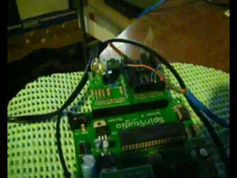

    My first Propeller project, way back in the old days of 2007, was a datasette emulator loading .tap files from SD card! :)
    Have a look at OBCs demonstration below:
    And as PIK33 stated, it shouldn't be too hard to get "something" working regarding a 1541 emulator.
