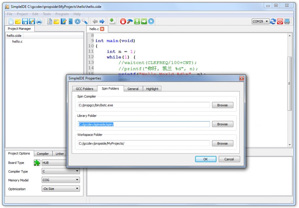

  • RsadeikaRsadeika Posts: 3,877
    edited 2012-07-20 10:30
    Click on the wrench, that opens up a window for SimpleIDE Properties. Click on "Spin Folders", which has the "Library Folder", and the "Workspace Folder" blank. On my system, I have my PropGCC folder on a server, so that is the folder that gets placed in Library and Workspace Folder.
    Ray
  • jazzedjazzed Posts: 11,803
    edited 2012-07-20 11:13
    @4x5n,
    Glad you're new project is working ok now.
    Sorry for the library confusion. The problem is a bug and has been addressed in my repository. The installer will normally add the folders for you on Windows.
    Rasadeika made some nice instructions. Compare that with the attachment. It highlights where the library folder is set for my computer. Follow that example, but browse for you spin library
    Your library may be in a folder like: C:\Program Files (x86)\Parallax Inc\Propeller Tool v1.2.7 (R2)
