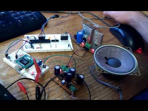

Hello,
I have used the RC Systems V8600A modules in a few projects and it works great. It is one of the best modules that I have run across. A nice feature is that while many other speech chips have come and gone this one has been around for years. I haven't used their V-Stamp yet.
The SpeakJet does work well for projects that you want a robotic sounding voice. I just received one of the new SPO-512 chips and will be testing that on the weekend to hear how that works. It should work well in some robot projects. The only downside I see with that chip is that it should have a bit more handshaking signals available for status back to the host controlling it.
Robert
[video=youtube_share;8915Vs0mzck]
Here's the DAT section of the code used in the above demo. I just noticed I left off one of the "T"s of "TTS256".
I had planned to compare the SpeakJet with one of my Emic V1 modules, but I some how managed to destroy both of my Emic boards. I'm pretty sure one of ruined by being used with a Propeller Protoboard without an enclosure on my lab table for a couple of years. I think it had been splashed with some corrosive chemical that slowly eat away some of the leads of the main chip. I don't know what I did to my other Emic board. It will echo the text sent to it, but it doesn't produce sound.

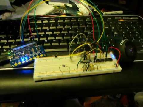

Actually, that's the only one I found on yt. I can't tell if it's plugged into his computer. Can it work with a stamp or propeller? Who knows?
Anyway the Emic 2 Text-to-Speech Module is in Accessories-Sound/Audio (!) But there's no button to add it to the cart yet.
http://www.parallax.com/Portals/0/Downloads/docs/prod/sens/30016-Singing-emic2_demo1.wav
and
http://www.youtube.com/watch?v=vDElgpRNjeY
