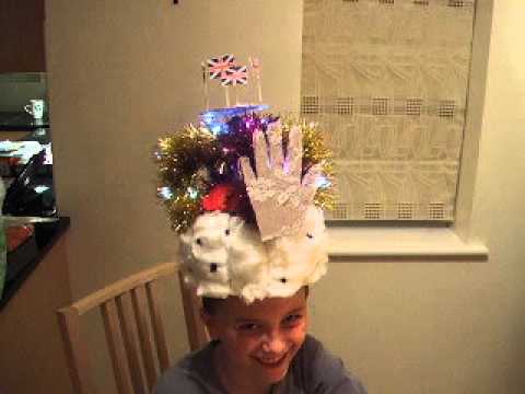

This project only started on Monday - and here it is on Friday finished ....
My son came home from school "Dad - we've got a competition for the Queen's Jubilee" - We've got to make a crown.... there is a prize for the most ingenious! ( for those non members of the commonwealth it's the 60th aniversary of the Queens coronation - and we get a public holiday).
So we thought about what we could do ... and this tasteful and understated little confection was the result.
The final result utilises some old christmas lights rigged to a separate 9V battery and, for speed of development a BOE with an onboard 9V
1/ 2 Servos linked to servo ports 14 and 15 - one operates a home-made continous rotation servo and the other a mini servo - these drive the waving hand and the rotating union jacks
2/ A speaker between pin 9 and earth programme
3/ finally a switch rigged to set pin 3 as high or low
The programme is simple enough - ( thanks Duane Degne by the way for the de-bugging help) :thumb: :thumb:
My code goes like this :
1/ sits in a loop waiting for a high on pin 3
2/ Goes to a loop to play "God save the queen"
3/ .finally activates the servos before returning to the loop. Warning this does devour 9v batteries :smile:
In the unlikely circumstance that anyone should wish to repeat such an exercise here's my code (extensively poached and adapted from "what's a microcontroller" )

    Cheers Guys - thanks for the support !! -
    James came back from the competition - we won ! is there no end to the versitility of the basic STAMP ?!
