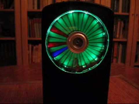

I saw this online and thought that it would be a cool thing to add to my desk at work.
http://www.youtube.com/watch?v=K1asNB0te0o
I have already sorced the HDD and made the appropriate modifications but now i am trying to decide what route to go with for a controller for the LEDs and time keeping functions. I would like to incorperate a LCD screen and only use the Platters when i want to show it off.. Maybe have an external switch or something to turn the HDD display on. I was thinking of using the chip out of a chronodot for time keeping with a super cap to eliviate power losses. Some buttons or a 5 way joystick would be nice user interface to change display settings and time. I have never programed with the Propeller but it lookes like it wouldn't be hard to do since the OBEX will have half the code for this thing.
Has anyone done this or know if the Prop would be up to the task? The disk i have is 7200 RPM which would be 120 FPS each frame would have segments of the display divided by say 6 degrees giving you an RGB value for 60 different positions 120 times a second. CAN IT BE DONE

    I have never used a prop but i am now looking forward to expand my knowledge. I am looking to design a piece of electronic artwork for my desk. I will be making a printed board and will attempt to enclose it all in one piece including power supplies. Actually Phil I have already opened up 3 broken drives one of which was a server drive designed to spin at 15k RPM. I was quick to tear this thing apart so i cut the slot out before figuring out how to keep the thing spinning. Apparently most newer drives will shut down the spindle drive circuit if no data is read from the read arm. I got it to spin up to its designed speed and no flying shards and to be honest with you it really wasn't that out of balance. I removed one of the screws on the opposite side of the slot and the vibration was almost eliminated. I had almost the same amount of vibration as an untouched drive. i was digging around with my scope trying to find a logic level to control the spindle motor and found that it was controlled over a serial line and then i messed up and shorted a couple of pins with the tip of the probe... oops. no more spin... tore open another drive only to find out that it was controlled the same way. I found one last drive and took a look at the board and found that the drive circuit was not just a chip but several components and stages. i disconnected the read arm and bingo... still spins. no modification needed!!!.. I cut a slot out of the top platter with a dremel and filed down the sharp edges i left a little material (1/8th" or so) at the outer most and inner most edge. I removed that one screw opposite the slot and whamo zero vibration and very quiet in comparison to my first attempt. This drive is 7400 rpm and very stable. my next step is to attach a small magnet like the one on the read arm parking assembly to the bottom platter and re-balance. My goal is to mount a hall sensor to the base of the frame and use this as a zero degree flash.

    Sorry about the confusion with the placement of the magnet. You are absolutely right. The magnet should be placed on the same side as the cut. My latest drive does not have a cut all the way. It has some meat left at the spindle and some left at the outermost edge. I think using this technique, balancing the drive as best as possible, filing the edges of the cut (produce less turbulence) and then covering the whole thing with lexan should provide enough safety. I think as long as its not dropped we should be OK.
    i am loving all the ideas. Some pretty cool thoughts. I like the propeller pov display using a propeller... kinda makes since . I think since i haven't seen too much with this type of hdd clock when this is all ironed out i will post some design notes and some how to for others.
    The tech for this thing seems to follow a certain pattern for the most part. As far as i can tell we need to measure the time between passes of the hall sensor and divide this time by a certain number of possible positions of the clocks arms. For instance. If we measure a 7200RPM drive we would get around 120hz pulse from the hall sensor or 8.333 ms between pulses. If we decided on a 6 degree arch then that would give us 60 possible places for the hands to exist. This shows we need each "position" to be
    138us per hand position. If this is put into an algorithm each rotation and the display is drawn the next rotation then we have a display that will not be sensitiveitive to RPM.

    I installed a hall effect sensor pulled from a cpu fan and it works beautiful. 120Hz pulses = 7400 rpm. I made a transistor circuit to use the pulse to strobe an led. This helped me align the top platter so pulse happens when the slot on the top platter is at the 12 o'clock position.
