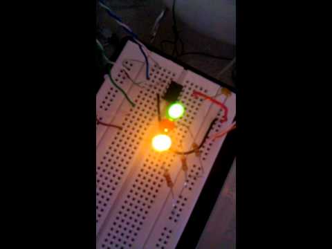

Hello and thank for any help. I have the following code. The problem is that for some reason went current its = to target i want outa 3 and 4 to go off wait 60 seconds and next outa 5 need to go off. but instead the program wait about 6 sec and put off all at the same time...

    Thank for the help. Here is the complete code (It's no finish and its only one PUB) I changed to waitcnt (clkfreq + cnt) and i still having the same problem. Also the 1st if "if current > target" work fine.. outa 5 go on wait 1 sec and outa 3 go on. The problem is only on current == target

    i will double check (It's possible because i and pretty new programing...... :-) ). But i just change the wait time to one second and the repeat to 10 (To get the 10 Seconds...) And now it's working but with a delay..... Can be a stack problem?
    [video=youtube_share;toYoGafc-lA]
