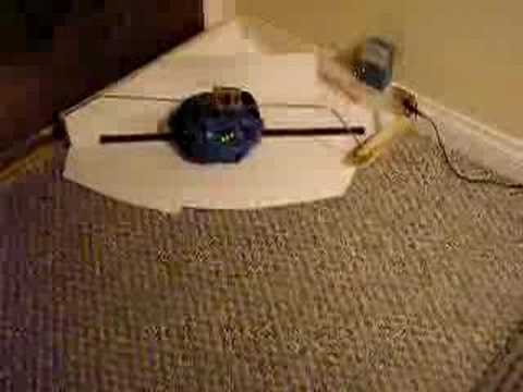

    What about using some form of "beacon" like an IR LED that the Boe-Bot can look for and orient back to? (like roomba)
    edited 2012-02-07 11:14
    Just Jeff wrote: »
    Kinda like...
    edited 2012-02-07 11:36
    Beacons are an easy way to find your way back to an origin point. But if you don't want to do that dead reckoning is another possibility. The BOE Bot encoders can help do this:
