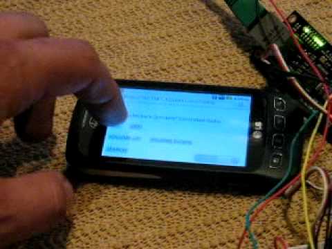

I thought I would combine two fun Parallax offerings into a single project.
* Spinneret and FM Radio module.
The goal here is to have an FM radio which can be controlled from my android phone both across the room and across the world. The hardware for this project is easy, and I'll post software as we go along to help others replicate the project. See message two for project videos.

I've got some software working! As soon as I clean up the code a bit I'll post it.
Had some trouble getting signal today in my office, but you can see it working.
Another video of it actually getting signal.

Added additional demo videos to the thread. (See message 2)
