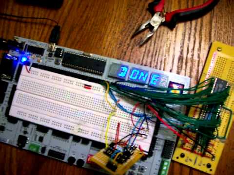

Hi all, I finally got around to connecting 2x PCA9555's to the Propeller Professional Development Boards 6x - 17 segment displays. It does a test of all digits and segments, then displays the word DONE.
But... When displaying the word DONE, I notice some flicker, How can I eliminate the flicker? I want to fix this before I continue. It is sorta small, but I notice it and it bugs me. I sense that as I write longer code the flicker will increase.
Added my code and the PCA9555 driver in the attached zip. I appreciate any help with this as the connections to the display can be daunting.O_o Wiring diagrams are in the comments.

Here is a video of the Program running, when the camera Zooms you can see the flicker, it is more noticeable than what the video shows.

If you have an extra cog available try using it just for driving the display.
