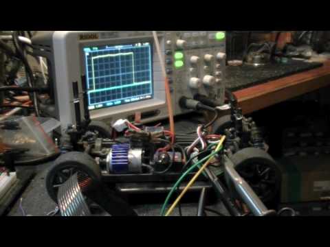

    Check out this video maybe a visual will help I know it helps me understand.
    Ron
  • stevebzzzzzstevebzzzzz Posts: 38
    edited 2011-07-18 12:24
    Great video. I'm gonna have that repetitious sound in my head all day long! Yea, that really did help me understand. Now I can move on...
    Thanks!
