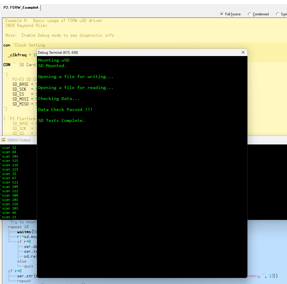

Second, switching from actual serial output to debug serial terminal output as default.
Be sure to enable Debug to see output.
But, easy to switch to real serial output with change in ser object.
Also, making this maybe more simple example, ExampleA.spin2

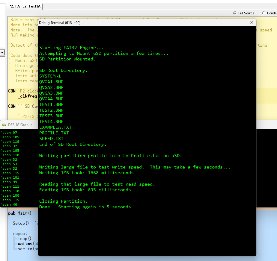

Just posted Fat32 test here.
Fat32 offers more features (like directory support) that FSRW, but is bigger and perhaps harder to use...

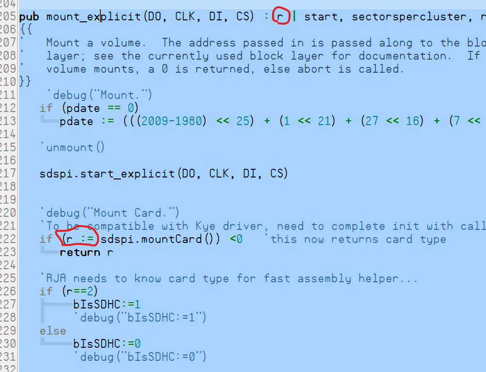

    May I suggest a small update? Until I did this I had problems. Most methods return 0 if everything is fine, and my code generally looks for that. In this method the return variable is used in the SDHC test which will cause the method not to return 0, even on a good mount, if you have an SDHC. I added r := 0 after this test and everything worked as expected.
  • RaymanRayman Posts: 16,253
    @JonnyMac Think this is included in that Fat32 version, but I'll double check...

    Ok, think seeing now that FSRW doesn't need to change for Fat32, but the low level block driver "bashed", etc.
    Seems that first post example already has that modified low level driver...
    @JonnyMac Seems that it is now FATEngineStart() that needs that change and did it.
    See now that FSRW was already adapted to work with Kye's FAT32 code...
    In Mount_explicit(), start_explicit used to do the work, but now it just sets pins... MountCard() is what now does the work...
       sdspi.start_explicit(DO, CLK, DI, CS)
       'debug("Mount Card.")
       'To be compatible with Kye driver, need to complete init with call to mountcard()
       if (r := sdspi.mountCard()) <0   'this now returns card type
          return r
       'RJA needs to know card type for fast assembly helper...
       if (r==2)
            bIsSDHC:=1
            'debug("bIsSDHC:=1")
       else
            bIsSDHC:=0
            'debug("bIsSDHC:=0")
