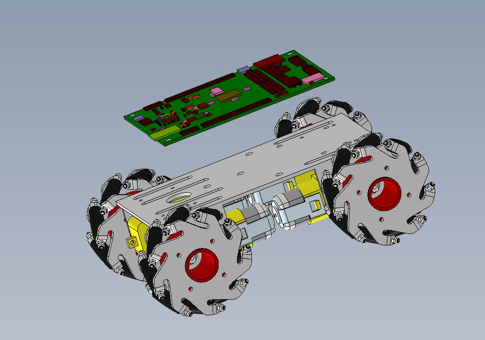

Started working on this thing... Think will fit with P1 to start with...
https://www.amazon.com/dp/B09P2XR91Z?th=1

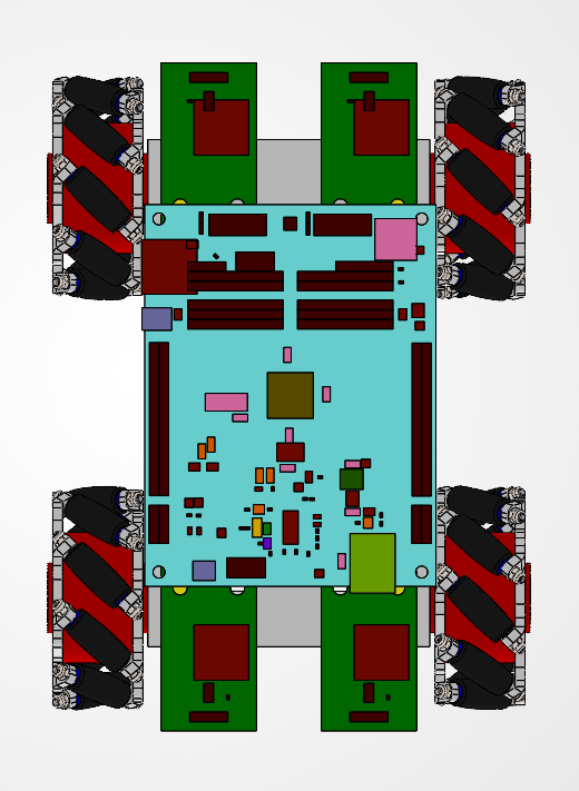

Drew it up in SolidWorks to help think about motor driver PCB...
Think will use two of these dual motor drivers:
https://www.amazon.com/dp/B0F43L7LLD?
Sparkfun also sells something that looks identical, in case these ones are bad for some reason...

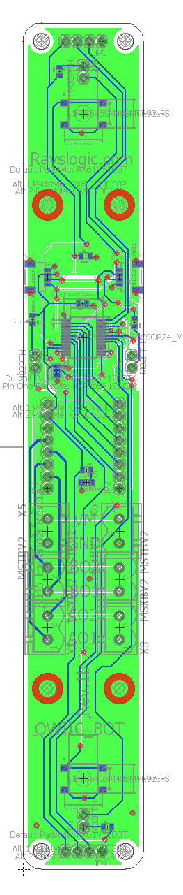

    Just ordered these long boards to drive the motors...
    The idea is that everything is controlled by one QWIIC cable from Propeller PCB.
    Uses two of these boards, one for each side. Each has a 16 I/O Expander and a dual motor driver (plus some extra stuff).

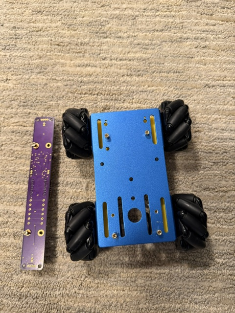

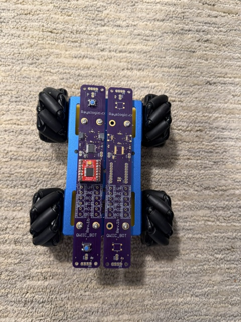

    Finally got around to working on this...
    I2C I/O Expander is working.
    Original plan was to generate the PWM for the motors using a pin in I/O Expander. But now, think this is too hard and may not work right...
    Going to use P1 I/O for PWM instead now.
    Did this form and fit test on the bot with the I/O Expander / Motor Driver boards.
    Had to drill out some of the holes a bit to get M3 standoffs in. Only using 2 screws to connect these boards to robot. Using unsecured standoffs for the other two holes...
    Just remembered that going to need some battery packs in there too, have to figure that one out still... Maybe 3D print some kind of holder...
    Wish the name was "Mechanum", but guess it's "Mecanum", bad decision... Anyway, had to change the name of this thread and some folders to match the unfortunate reality...
