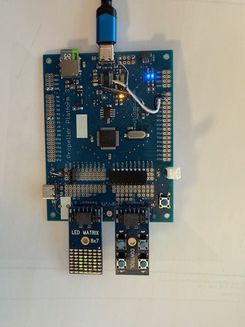

    Testing out some P2 accessories on P1 board with Eval style headers...
    First test is LED Matrix with CONTROL.
    Didn't take too much to make this Spin2 code and P2 accessories work on P1...
    Had to make some changes:
    • Change RX and TX for P1
    • Replace serial with fullduplexserial (as P1 does not have smartpins for serial)
    • In the matrix driver, just had to explicitly float the pins as Spin2 on P1 cannot apparently use pinfields
    • In the random driver, had to remove the P2 style random as P1 doesn't have that
    • In control, had to comment out the wrpin as P1 doesn't have smartpins
    Think that was pretty much it... Should remove the clock setting code, but FlexProp appears to be ignoring that, so not a big deal.
    Not actually sure if random driver is working, but maybe it is.
    The CONTROL buttons seem to work, except for the one that is supposed to show "2" on the display. Should look into how to better adapt the control board...
    The LED matrix looks dim to me, but also dim on P2. Think they should not have added all those 470 Ohm resistors...
    Anyway, this seems like a good sign that converting P2 code (at least simple things that don't use P2 specific hardware) to work on P1 is fairly easy.

    Think have control accessory working now.
    Just doing the usual thing of pulling down the pin and then floating just before reading...
    This should work for P2 as well, but P2 has the internal pulldowns, which is better...
