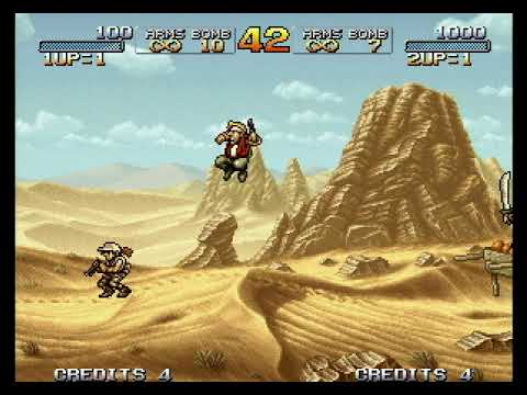

    I've started to implement the new EmuPad code.
    Targeted features:
    - report up to 10 buttons + 8 directions + device presence into an array of longs in user-provided memory
    - report format configurable by spin constants
    - support for any HID device (with ability to load button maps from file)
    - keyboard support (maybe also file-loadable)
    Current "hot garbage" proof concept code is attached. I've also wrenched it into NeoYume (MegaYume does more complex stuff) for a little proof-of-concept:
  • @Wuerfel_21 said:=
    Nice one. Good to see it already doing something interesting in NeoYume. Will eventually have to get another one of these and build up a second joystick setup soon for proper dual player gaming. :smile:
