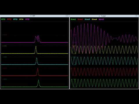

  • cgraceycgracey Posts: 14,289
    edited 2020-08-29 02:26
    I've finally got the FFT debug display working.
    This code:
    PUB go() | i, f[5]
      ' Set up FFT
      debug("`fft f pos 100 600 size 600 500 samples 1024 1024 0 49 linesize 1 dotsize 3 textsize 12")
      debug("`f 'FFT1' 0 1000 70 10 15")
      debug("`f 'FFT2' 0 1000 70 110 15")
      debug("`f 'FFT3' 0 1000 70 210 15")
      debug("`f 'FFT4' 0 1000 70 310 15")
      debug("`f 'FFTX' 0 1000 70 410 15")
      ' Set up scope
      debug("`scope s pos 100 600 size 600 500 samples 1024 linesize 1 textsize 12")
      debug("`s 'Sine1' -1000 1000 70 10 15")
      debug("`s 'Sine2' -1000 1000 70 110 15")
      debug("`s 'Sine3' -1000 1000 70 210 15")
      debug("`s 'Sine4' -1000 1000 70 310 15")
      debug("`s 'SineX' -1000 1000 70 410 15")
      ' Generate waveforms
      repeat i from 0 to 1023
        f[0],_ := polxy(1000, i * $03000000)
        f[1],_ := polxy(1000, i * $05000000)
        f[2],_ := polxy(1000, i * $07000000)
        f[3],_ := polxy(1000, i * $09000000)
        f[4]   := f[0] + f[1] + f[2] + f[3]
        debug("`f ", sdec_long_array_(@f, 5))
        debug("`s ", sdec_long_array_(@f, 5))
        waitms(20)
    Makes this (we are looking at FFT bins 0..49):
    Note how all powers are 1:1 with input amplitudes. Magnification is Power(2,n) and n=0, after the 'FFT' labels.
    Next, I want to make a rolling spectrograph display and then I'll document all this and output a new version of PNut which has all this in it.
    622 x 1150 - 24K

    I found some ways to make the graphical debug windows run a lot faster, by adding a RATE parameter which updates the window's graphics on every Nth datum received, and also by polling for received data differently. Ultimately, I need to get the data reception into its own Windows thread, so that nothing can clobber it.
    PUB go() | i, j, w[5]
      ' Set up FFT
      debug("`fft f pos 0 0 size 600 600 samples 1024 0 127 rate 70 linesize 1 dotsize 3 textsize 12")
      ' Set up scope
      debug("`scope s pos 623 0 size 600 600 samples 300 rate 70 linesize 1 textsize 12")
      debug("`s 'WaveX' -1000 1000 70 410 15", dly(100))
      j~
      repeat i from 0 to 1024 * 80 - 1
        j += $800
        w[0],_ := polxy(1000, i * ($04000000 + j*4))
        w[1],_ := polxy(1000, i * ($07000000 + j*3))
        w[2],_ := polxy(1000, i * ($0A000000 + j*2))
        w[3],_ := polxy(1000, i * ($0D000000 + j*1))
        w[4]   := w[0] + w[1] + w[2] + w[3]
        debug("`f ", sdec_long_array_(@w, 5))
        debug("`s ", sdec_long_array_(@w, 5))
