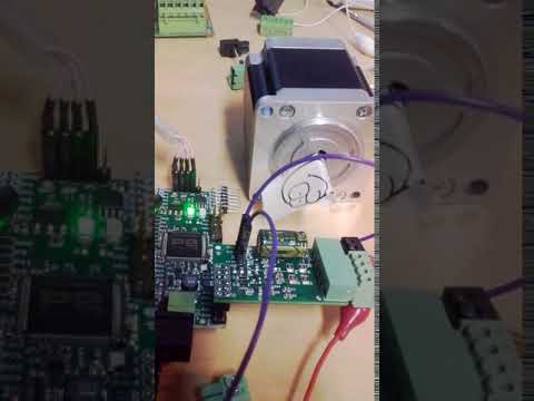

Here we go:
pull the plug of my telephone line - check!
load FlexProp, look up all the thinks I've forgotten in the last two months of programming abstinence (PC and ARM don't count) - check!
make some stupid mistakes, again, and find them - check!
Finally get some results...
check!
You are in the right business and what we see above proves it without a doubt. Being careful is highly advisable and (in most cases) pays off. Saves a lot of trouble.
The first demo runs without current feedback. The CORDIC is used to calculate sin/cosine waveforms which are output at a constant rate. And because the overcurrent protection isn't active yet I didn't dare to use a bigger supply with more than 24V.
I've hoped that I cound use a single cog for handling all the ADC inputs. But that doesn't seem to work. Filtering and demodulation of a single input takes something like 13 instructions. I have to process 16 inputs for 4 motors so that would be more than 256 clocks. If I switch to 512 clocks sample time I have only 16 samples per PWM frame left. As I have to ignore 3 samples after each PWM state change that's not much.
Maybe I can process the ADC inputs in the background as interrupt. If I dedicate one cog per motor that would take around half the computing power of each cog.
I'm still not sure what filtering mode I should use. SINC3 should give the best resolution but adds some complexity and time lag. I think I have to try all 3 possibilities from simple averaging to SINC3 to find out which one gives the best compromise of noise and resolution vs. response time.
At low speeds low noise and high resolution are important. I can average over multiple samples becauise PWM is near 50% so that should be no problem.
The most critical situation is when the duty cycle is just around 90% (I never get to 100% because the boost capacitor of the MOSFET drivers needs charging and that results in a minimum off-time). Then I only have one or two samples left.
Plain averaging is probalby better than SINC filtering because I get more samples.
I've watched the Zoom presentation, yesterday. Chip showed some example code using an interrupt to read the ADC. It looks like it's really not much overhead so it should be possible with interrupts.
Today I did something completely different but still related to this project. I'm too lazy to write test code that produces stimuli with varying speed so I just connect the driver to one of my existing CNC controllers.
The step/dir input already works well. Theoretically it could be done completely in the smartpins. There is an up/down counting mode. But I also want timing information to calculate speed with good resolution. The period measurement modes are not good for this because they mess up when direction changes or the timer overflows at very low speed.
So I dedicate a cog to take care of the time capturing.
handles step dir inputs for up to 4 axes. Not only pulses are counted
but also a timestamp is recorded at each counter change so that
velocity or frequency can be calculated by dp/dt =
number of pulses (delta position) divided by elapsed time (delta time)
between first and last pulses.
Frequencies up to sysclk/2 can be counted but timestamps are accurate
to ~1/4µs (one loop iteration) only.

For reasons described here I had to implement my own version of a symetrical (triangle) PWM mode. This works well by triggering a timer interrupt 100 cycles before the end of the current PWM frame and then inverting the output pin polarity and setting output enable to float at the same time. The smart pin interrupt (set event on pin rise) happens shortly after the PWM Y register has been captured and sets the output to enabled again. So the output floats for half a microsecond to avoid glitches.
ADC sampling with SINC3 filtering also works well. I get only +/- 2 digits noise at 12 bit resolution from a single 256 clock sample. So thats better than 10 bit accuracy with almost no noise without any averaging.
I still have to sort out the timing of the AC demodulation (synchronous rectification) with blanking to mask out the invalid samples (due to filter settling).
Thanks to Chips DAC presentation yesterday I was also able to successfully setting up a smart pin for the overcurrent comperator.
OK, the demodulation finally works and I can run the motor with closed loop current control. Park and inverse Park transformations for a rectangular coordinate system (2 phase stepper motor) are absolutely trivial with the P2 and only take a single QROTATE instruction each.
My first approach used a variable length averaging filter. It (hardly) worked but I had problems with its complexity. I have replaced divisions by multiplications with the inverse from a 1/x lookup table to speed the math up. But the variable sampling window caused a variable phase shift and caused ripple when switching over from one ADC input to another and the motor ran quite noisy.
Now I switched to a fixed and shorter sampling window, only 2 samples per PWM frame. The SINC3 filter mode gives quite good resolution (~12 usable bits at 256 cycle samples) so further averaging is not neccessary.
I think I can even go without VIO/GIO calibration. The AC coupling cancels out any offset errors and the gain errors from pin to pin seem to be quite low (the resistor ratios on the chip match better than the transistor threshold voltages).

Next step is the high speed part. Stepper motors running well above their corner frequency (usually >1200RPM or 1000Hz at the windings) are driven best with rectangular waveforms (same as full step mode). I thought I could also do this by clever adjustment of the PWM duty cycle values. But I need a different switching pattern.
This is used at low speed:
The triangle mode with alternating up/down counting has the advantage that the effective winding voltage and ripple current have double the switching frequency. This results in lowest possible switching losses and noise above the audible range.
At high speed we have a different situation:
The amplitude is saturated, this means the duty cycle is 100% for all frames except those containing a zero crossing. The zero crossings have to be carefully synchronized to the step input signal because the switching frequency can be a shigh as ~1/4 of the PWM frame rate meaning there's a zero crossing almost every 2nd frame. Wrong timing would lead to jitter or unwanted DC voltage.
The difference is that for the low speed case both half bridges always switch in the same direction (rising or falling edges) inside one frame. In the high speed case both outputs switch in the opposite direction.

Case 2 (low speed) and case 3 (medium speed) show the same detail of the motor voltages, a slightly positive average voltage crossing the zero line in the middle and becoming a slightly negative average voltage.
The difference is that in case 2 all PWM counters alternate between up and down counting at the same time. In case 3 counter 2 flips its direction in frame #2. This inverts the output of half bridge 2 and results in much wider voltage pulses at the motor winding. But the average voltage stays the same. So the pattern switching can be done without much disturbance.
The key is that the duty cycles in frame #2 of case 3 are voltage-driven (goal is smooth average voltage) whereas the duty cycles in frame #2 of case 4 are time-driven (goal is exact phase shift of the square wave). As both numbers are a continous values it is possible to "blend" between them by weighted multiplication with a "fading slider" parameter. In contrary, the PWM counter direction and output polarity is a yes/no decision and no fading is possible.
To make the typical stepper noise softer and avoid vibrations in the frequency range where mechanical resonances occur (10..100Hz) I've experimented a bit with filters. The idea is to low-pass filter the step input with an adaptive filter where the cut-off frequency follows the input frequency. This turns the typical microstepping "minecraft world" (see this waveform) into a nearly perfect sine shape while keeping phase lag (and thus position following error) nearly constant.
Step/Dir input signals control an up/down counter. Its output is used as an angle.
Together with the current vector absolute it is used for a polar/cartesian
transformation to generate (discrete stepped) sine/cosine waveforms as nominal
values for the winding currents.
To smoothen out the discrete steps the angle value is filtered with a second
order low pass filter. This results in a continous velocity and finite
acceleration. The time constant of the filter adapts to the current velocity
propotional to the step frequency.
Velocity is calculated as delta angle per PWM period.

Here we go:
check!
{ handles step dir inputs for up to 4 axes. Not only pulses are counted but also a timestamp is recorded at each counter change so that velocity or frequency can be calculated by dp/dt = number of pulses (delta position) divided by elapsed time (delta time) between first and last pulses. Frequencies up to sysclk/2 can be counted but timestamps are accurate to ~1/4µs (one loop iteration) only. } CON pinDir0 = 0 pinStep0 = 1 pinDir1 = 2 pinStep1 = 3 pinDir2 = 4 pinStep2 = 5 pinDir3 = 6 pinStep3 = 7 allPins = 0 ADDPINS 7 VAR long position0 long timestamp0 long position1 long timestamp1 long position2 long timestamp2 long position3 long timestamp3 ' position counters and timestamps are stored interleaved so they can be read ' in an atomic way with setq/rdlong for each axis byte cog PUB Start () cog:= cognew (@stepDirCode, @position0) + 1 ' @position0 into PTRA PUB Stop if cog cogstop (cog~ - 1) DAT ORG stepDirCode fltl #allPins ' reset smartpins wrpin mode_updown,#pinStep0 wrpin mode_dir,#pinDir0 wrpin mode_updown,#pinStep1 wrpin mode_dir,#pinDir1 wrpin mode_updown,#pinStep2 wrpin mode_dir,#pinDir2 wrpin mode_updown,#pinStep3 wrpin mode_dir,#pinDir3 wxpin #0,#allPins ' no period, continous drvl #pinStep0 ' enable smartpins drvl #pinStep1 drvl #pinStep2 drvl #pinStep3 loop rdpin pos0,#pinStep0 cmp last0,pos0 wz if_nz getct time0 mov last0,pos0 rdpin pos1,#pinStep1 cmp last1,pos1 wz if_nz getct time1 mov last1,pos1 rdpin pos2,#pinStep2 cmp last2,pos2 wz if_nz getct time2 mov last2,pos2 rdpin pos3,#pinStep3 cmp last3,pos3 wz if_nz getct time3 mov last3,pos3 setq #7 wrlong pos0,ptra jmp #loop mode_updown long P_MINUS1_B | P_SCHMITT_A | P_REG_UP_DOWN ' %0111_0000_000_0011000000000_00_01101_0 ' pin B = pin A - 1 mode_dir long P_SCHMITT_A ' no smart mode last0 long -1 last1 long -1 last2 long -1 last3 long -1 pos0 res 1 time0 res 1 pos1 res 1 time1 res 1 pos2 res 1 time2 res 1 pos3 res 1 time3 res 1 FIT

I've already built a servo driver with the P2 (see this thread). The hardware works but the software especially for tuning is a still uncompleted task.
I think a simple but powerful driver for stepper motors would be a good demo of what the P2 is capable of. It doesn't need expensive components or high voltage so I think it has much more the potential for a "killer application". Futhermore, I'll soon need a replacement for my old (P1 based) stepper drives. They become 10 years old and instead of a partial redesign to replace EOL components I prefer making a real improvement.
It is optimistic, yes, but it is also based on good grounds. I tend to be optimistic when it comes to recognizing somebody else's achievements and not so much at all when it comes to my own. Also, for a good reason
I think for a "killer application" demo it is good enough already at its present state.
The question that comes to my mind is this - what might be a real advantage of pushing the stepper motor to its high limit when the performance is sub optimal ? I'm sure there must be something but just can't figure it out at the moment.
When you say BOM <$25 (plus the slight increase for the extra parts ) do you mean for a four motor driver board ? That would be impressive indeed.
What do you mean with "performance is sub optimal"? Yes, a stepper has decreasing torque with increasing speed. But that's ideal for CNC positioning applications. You need the highest force at low speeds when your tools are actually cutting. When doing rapid moves you only travel "through the air" and don't need much power.
Yes, $25 for a four motor driver. Of course, this is not the end user price. It has to be produced, tested and sold (the dealer wants some profit). And we need a case, heatsink, terminals and so on. But even $100 would be quite competitive.
The "moment" was a shortcut that I shouldn't really use and I'm glad you pointed that out. After all, we're engineers and we should express ourselves precisely
You've just answered my question - I haven't thought of that but felt there must be something and indeed, I should have thought of the whole application and not just the stepper motor itself. I was under the impression the more flat torque vs speed characteristic the better hence my question.
You said BOM and I meant BOM, not the total cost for the customer so that one at least I got right and I agree, even at a $100 for a complete product would be a rather attractive price.
Step/Dir input signals control an up/down counter. Its output is used as an angle. Together with the current vector absolute it is used for a polar/cartesian transformation to generate (discrete stepped) sine/cosine waveforms as nominal values for the winding currents. To smoothen out the discrete steps the angle value is filtered with a second order low pass filter. This results in a continous velocity and finite acceleration. The time constant of the filter adapts to the current velocity propotional to the step frequency. Velocity is calculated as delta angle per PWM period. v = s * p / t Can be computed with CORDIC solver QDIV (64/32 bits) s = step angle (2^32 = 360° = 1 electrical turn = 4 full steps) p = PWM frame period in clocks t = time between to consecutive step signal edges in clocks Limits: 3000RPM = 50RPS = 2500Hz (50/s * 50 pole pairs) 2.5kHz * 4 = 10k full steps per second = ~1/2 full step per PWM frame vmin = 1 step/0.25s, tmax = 45_000_000 clocks fmax = 2.5kHz * 4 * 64 = 625 kHz (64 micro steps * 3000RPM) tmin = 180MHz / 625kHz = 288 clocks s*p < ~400*2^32 max @ 1/5 microstepping Low pass angle/position filter (RC type, e^-t decay), canonical formula: o:= k*i + (1-k)*o o = output, i = input, k = filter coefficient To avoid trouble with overflows and rounding errors, re-order formula: o+= k*(i-o) Advantages: term (i-o) never overflows, only one multiplication required k = p/(t+p) Can be computed with CORDIC solver (QFRAC) ... ORG FilterCode setq spHi qdiv spLo,deltaT mov temp,period add temp,deltaT getqx velocity qfrac period,temp getqx filterK shr filterK,#16 mov temp,filterI sub temp,filterO1 sar temp,#16 wc addx temp,#0 abs temp wc mul temp,filterK sumc filterO1,temp ' o1+= k*(i - o1) mov temp,filterO1 sub temp,filterO2 sar temp,#16 wc addx temp,#0 abs temp wc mul temp,filterK sumc filterO2,temp ' o2+= k*(o1 - o2)
It's amazing how simple the computations are on the P2. The code that does the same thing on the P1 spans multiple pages and takes all the resources of one cog. I even had to skip filtering at higher speeds to avoid cycle starving.
