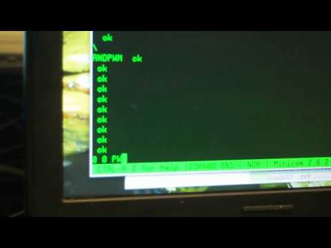

    I didn't have time to do a video the other day but I have thrown a quick intro together showing how PWM is started up and how we can make changes. Now I am running 18 channels and displaying this on the logic analyser.
    [video=youtube_share;QKN7ggWGnQk]
    Here's the sample code I used to demonstrate it:
    [FONT=courier new]DECIMAL
    ( STEP 1 - allocate memory for a table somewhere )
    TABLE pwms 1024 BYTES    \ allocate a 256 longs table for the PWM map
    ( STEP 2 -specify a frequency )
    7600 PWMFREQ        \ Set the frequecy
    ( STEP 3 - specify the outputs and the address of the table and start the PWM cog )
    \ Start up PWM using from P0..7, P16..P23 for 16 channels
    %00000110_00000000_11111111_11111111 pwms RUNPWM32
    ( STEP 4 - set the duty cycle for indivdual pins or groups of pins )
    25 % 0 31 SETPWMS
    10 #P4 SETPWM        \ set P4 to 10/256 duty
    50 % 2 SETPWM        \ set P2 to 50 % duty
    1  25 SETPWM
    255 26 SETPWM
    \ Read bytes from memory and set channels
    : LOADPWM ( addr -- )  32 0 DO DUP I + C@ I SETPWM LOOP DROP ;
    \ $FF80 LOADPWM
    \ Just set all 32 channels to a random level
    : RNDPWM  32 0 DO 256 0 GETRND I SETPWM LOOP ;
    \ create an easy alias for SETPWM
    : PW  SETPWM ;
    \ pwms DUP 128 + $3C0 <CMOVE
    [/FONT]

    Really Neat! Thanks for the video
  • JonnyMacJonnyMac Posts: 9,530
    edited 2014-03-07 09:52
    Thanks for the video, Peter -- now I understand how the code works and made a Spin version (for my own edification). I don't know that the Spin version (i.e., Spin interface to PASM code) is practical, though, because it takes ~10ms to update the table for a channel value (unless I'm really missing the mark here).
