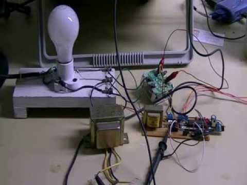

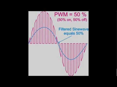

This is another TRIAC option.
Here's a video showing how to use a IGBT transistor to control an AC load.
I couldn't find the exact transistor "IRG4PC50PbF" at Mouser but Mouser carries this one, which I figure should work.
It sure seems like this second video is treating the load like a DC load.
Any suggestions on which option is best for the blower?

The two videos I posted use optoisolators. Probably both of the two methods shown in the videos should work well, I'm wondering if one method is better than the other.
