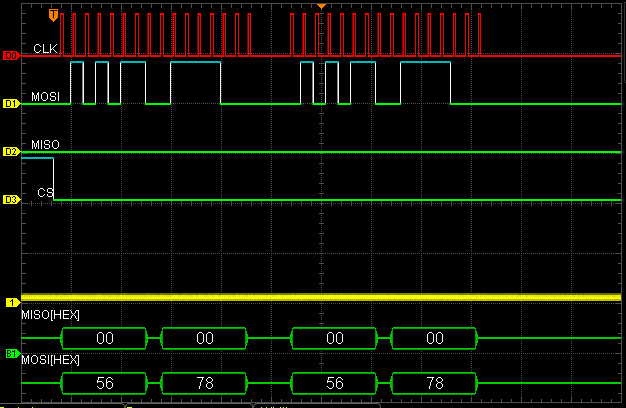

Now here is SPI being used to talk to the WIZnet W5500 Ethernet chip highlighting just two basic methods of reading and writing a byte at an address.
Capture of multiple 16-bit SPI writes to a W5500 chip.
pub LC! ( byte wizadr -- )
SPIWR16 DROP --- write address
WR_WCTRL --- control byte
SPIWRB DROP --- write a single byte
SPICE --- release chip select
pub LC@ ( wizadr -- data )
SPIWR16 DROP --- send addr
RD WCTRL --- control byte
0 SPIRD --- read back data
SPICE --- release chip enable
