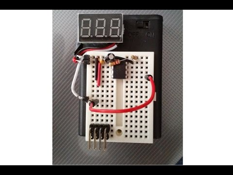

Nonetheless, I'm sharing this little experiment because it can apply to any processor that can output a PWM signal (or just bit bang one). I wanted to retask some of the dollar (ten for $10) digital voltmeters I got off Ebay. Ignoring the decimal place, these voltmeters can make general purpose 3-digit LED displays, using just ONE I/O pin. I did some curve-fitting and came up with a linear conversion to make a variable into its corresponding voltage. That is, value 1=0.01V, 37=0.37V, 127=1.27V, etc. It's surprisingly accurate over the whole range, 0-2.55V.

    I'd be worried about using to display numbers that have to be correct. Any drift in your clock or mis-calibration of the meter gets you the wrong display in at least the last digit.
    Would be great for displaying continuous variable values though.
    And you can drive many of them with the multi-channel PWM objects.
    edited 2015-06-05 07:52
    Agreed, not recommended for mission-critical applications or life support systems! Interestingly, the values displayed are rock-solid after about a second, it takes the dollar DVM a while to stabilize. Any variations here are because I sped up the numbers to keep the video from being too boring. Further, the chip here is run off of unregulated DC power, namely 3x AA cells. The supply voltage should be well regulated for accuracy.
    This was just a wild hair I tried since I put these little DVMs on my student breadboards. They can easily display supply voltage, analog sensor voltage, and I'm trying to come up with a few other novel uses.

    I was pleasantly surprised that these little DVMs auto-range the decimal point. They go up to 32V, so obviously they show one digit after the decimal, in tenths of a volt. But under 10 volts, the decimal shifts to show 2 digits, of hundredths of a volt. Pretty spiffy for a buck.

    The madness continues. I continue to be surprised at the accuracy/repeatability. Until the batteries weaken and my calibration fails...

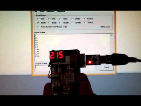

    Here displaying ADC results on the DVM with good correlation. Round trip: analog to digital to analog. I'll be building a dozen setups like this soon, it will be interesting to see how much the accuracy varies between units.

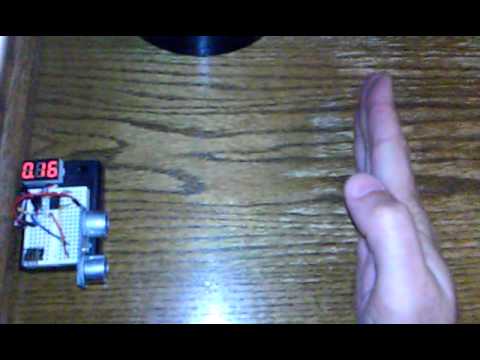

    Edit: And here's a 2-pin ultrasonic distance display:
