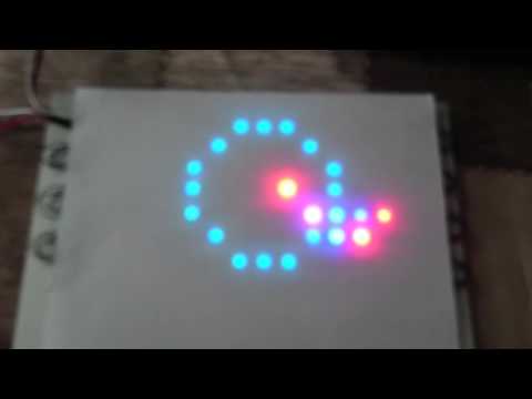

After JonnyMac told me about NeoPixels, I decided to give them a try.
I purchased three NeoPixel Rings from AdaFruit. Each ring has 16 NeoPixel LEDs.
While I have done several different RGB LED projects and I think I've come up with some fun patterns to display on LED strips and arrays, I wanted to come up with some algorithm to take advantage of the circular configuration of these rings. I was hoping to come up with something with a hypnotic feel.
Here's my attempt.
I had a tough time recording these LEDs. I found the colors as seen through the camera looked washed out. I found placing a piece of white paper over the LEDs helped preserve the color a bit. I'll need to break down and read the manual on my camera to see if there's a setting which would allow me to better control the exposure.
I'll post the code I used in post #2 of the thread. The circular rotating effect is my own algorithm. I'm sure the algorithm could be simplified a bit. My algorithm uses the "wheel" algorithm JonnyMac translated to Spin from an Arduino sketch (I believe he found the code on the AdaFruit site). I used JonnyMac's WS2812 driver to send the color information to the LEDs.
Thanks again JonnyMac for sharing your driver code. Having your code as a starting point has made writing code for many of my LED projects much easier.
Though I'm marking this project "Completed", I'm going to reserve a few extra posts in order to leave some room for possible future updates to this project. I'll add any other interesting algorithms or applications I may come up with for these NeoPixel rings to this thread.

    As I rewatch the video I notice there are a lot of little glitches in the LEDs. They seem particularly noticeable starting at 0:24. I thought the glitches were caused by a bad solder connection but I remembered some discussion about using level shifters with NeoPixels and I tried adding a level shifter to my project. The level shifter immediately cleared up the glitches. The glitches hadn't been bad when I was powering the LEDs from the USB connection but when I started using a switching regulator the glitches were much worse. As I recall, the person posting about problems using NeoPixels on a PropBOE didn't have trouble until they switched from USB power to using a battery pack through the PropBOE's switching regulator.
    I haven't used level shifters on any of my WS2801 projects but I think I'll need to use them on my WS2812 projects.

    edited 2013-11-05 13:10
    Duane Degn wrote: »
    FWIW, it might be that the LEDs are being overexposed because the meter is averaging the scene and the darker background is causing it to use too long of an exposure (or a wider f/stop) than it should. While it might seem counterintuituve, you might try increasing the ambient light levels so the camera uses either a smaller aperture or a shorter exposure. Sometimes even cameras that don't allow full manual control will also allow exposure compensation. If you used that to decrease the exposure a stop or two I think it might help though the background will probably become nearly black. Naturally the best option would be full manual, where you could simply adjust the shutter speed and aperture to get what looks best.

    edited 2013-11-08 22:44
    jones
    your suggestion seems to be very good.
    It makes sense to me.
    I've always had trouble with photos with both light and dark in the same frame.
    I'll be trying your suggestion.
