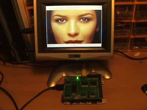

    Hi guys,
    just a quick update. I could fix the TV driver demo to make the image on screen stable .
    This driver takes advantage of the CounterB that drives directly the control lines of the C3 Synapse. In this way there's enough time to read 256 bytes from the frame buffer and display them in the active line. The frame of a qwaitvid instruction can be reduced to 1 pixel only.
    So here what you can do with this driver and a C3 Synapse:
    Resolutions:
    256x192x8bpp
    256x224x8bpp
    256x240x8bpp
    Color depth:
    The color is in the Propeller format ( Chroma << 4 | $8 | Luma ), so 1 byte = 1 pixel
    Extra:
    Frame buffer pointers are accessible to SPIN for creating scrolling effects.
    IT USES ONLY ONE COG.
    C3 Synapse actually doesn't need a special and heavy driver, so you simply include few settings inside the TV driver and that's it!
    Here it is the photo of a Catherine Zeta Jones at 96 color 256x224 read from the Frame Buffer.
    C3 Synapse is coming very soon!
    Enjoy!
    edited 2012-06-15 15:11
    Very nice indeed!
  • digimorfdigimorf Posts: 74
    edited 2012-06-17 03:29
    Thank you.
    As you can see from the photo of the LCD Screen, the resolution takes more or less the whole screen. In fact the Pixel clock is = 11.
    I could also use Pixel clock of 10 to make the whole image to fit on a CRT monitor. But to achieve that I used a second Cog that caches the scanline from Synapse.
    The cache is trigged at hsync of each scanline, so that there's enough time to cache data before the driver reads it :)
    The caching method,driven by the internal counter, can store data on shared memory at a speed of 5Mhz.
    At th is speed you could cache easily more pixels for a line, and with some optimization you probably can reach 320 pixels!
